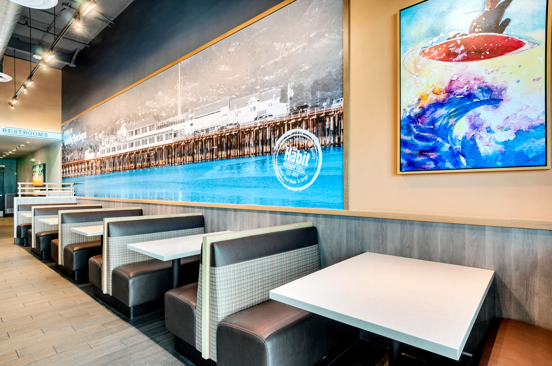

Habit Burger Features Lotte Staron and Radianz
Staron® solid surface and Radianz®  quartz are installed in areas where food routinely comes into contact due to its non-porous and durable qualities that help resist any stubborn stains and minor scratches. Staron® Tempest Horizon and Radianz® Ural Gray are prominently featured at Habit Burger locations for the surfaces of their furnishing solutions.
The contemporary design is complemented by the simplicity of Staron® and Radianz®  throughout the restaurant’s dining and cashier areas. Available in a wide range of colors, Staron® and Radianz® help create a signature look that can be extended to other franchise locations.
Achieve the best of style and quality with Staron® solid surface and Radianz® quartz brought to you by LOTTE Advanced Materials USA

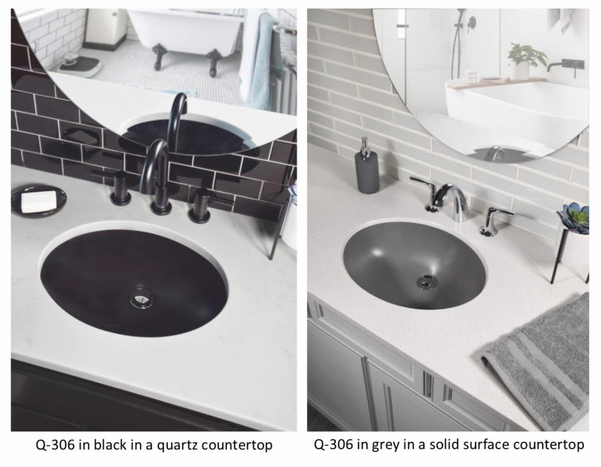

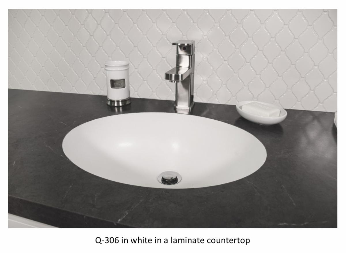

Karran Quartz Vanity Bowls
New to the market this month is our first quartz composite vanity bowl. This stunning bowl is available in our six standard colors. With its machined top rim, it can be seamlessly integrated into laminate, solid surface and stone countertops.
Looking for the industry’s first quartz composite vanity bowl for a commercial project but need a specific color? With our quartz composite’s wide array of custom color options, we may be able to give you the perfect color for your next project.
