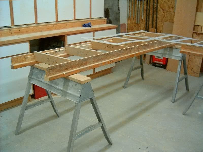

    I thought I would let you all know of a reasonable way to make some work bench stringers similar to those Andy has.
    I got to thinking about the way he rabbetted the plywood into the bottom flat peice and it reminded me of the engineered floor joist called TJI. My local lumber yard stocks these in 9 1/4″ height with the flange being 21/2″ wide and the center peice between the 2 made of 1/2″ wafer baord(OSB). So I was thinking these things will carry 460lb live load 16″ OC and span 14 feet no support, surely if I ripp these things in half I would get plenty of span and carry weight for making countertops. So that is what I did and so far so good can use only two sawhorses and two stringers no sag so far clear out to 12 feet. Cost for each TJI was about $1.89 per foot split it in half and makes one set. Beauty is can get these things clear up to 48 feet if really want to go nuts. Just thought I would share this info if someone looking for a good way to make the stringers and do not own a CNC to get tight joints like Andy’s.

    #23654
    Andy Graves
    Keymaster
    Reuben sent me this picture of his new benches.
    #23671
    David Gerard
    Member
    Simple,strong,light and portable, good show, I like it!
